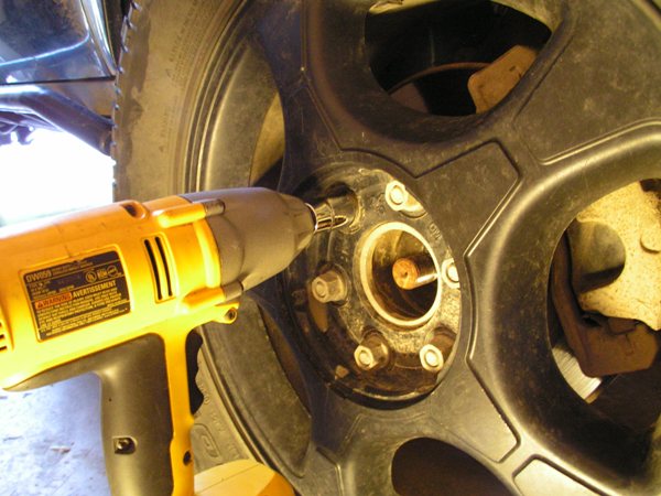

1. Remove axle nut. Requires 35mm deep socket (or possibly 36mm if you have aftermarket CV shafts).

7. Remove the wheel spacer if you have one (I find it easier to use an impact wrench here), and remove the brake disk. My wheel spacer had seized to the hub’s inner bore. If that happens to you, you’ll have to be crafty and find a way to pry on the back of the brake disk.
